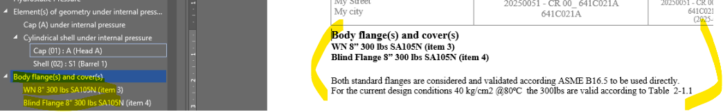

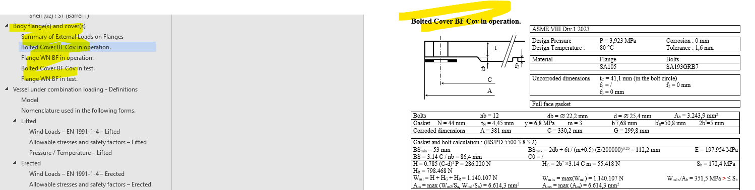

However, I haven't found a way in the software to skip or disable the specific flange calculations when using these standard flanges. Every time I run the calculation, the software automatically includes this section, and I end up having to manually modify the report—deleting the unnecessary flange calculation results and replacing them with a general note stating that the flanges are validated per ASME B16.5/B16.47.

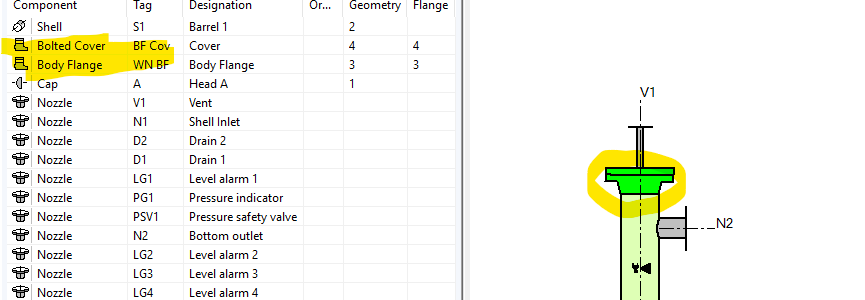

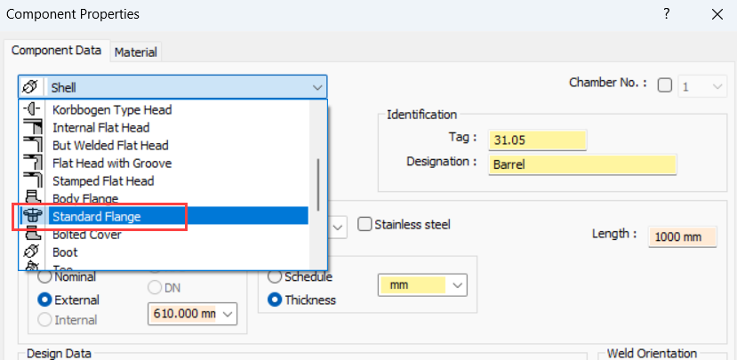

When using standard flanges and flange calculations are not required, it is advisable to select the 'Standard Flanges' option rather than 'Body Flanges.' Choosing standard flanges ensures that the software will omit flange calculations.

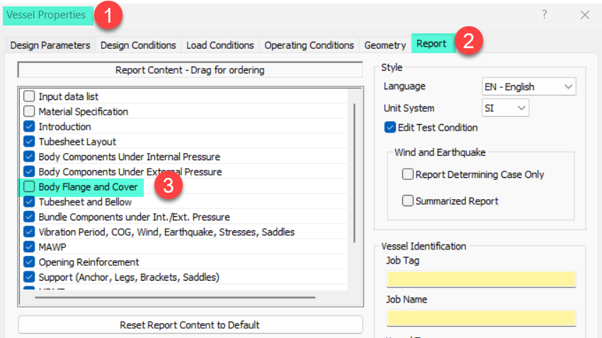

If a body flange has been added but you prefer to exclude its calculations from the report, you can simply deselect the 'Body Flange and Cover' option under Report Content (Vessel Properties > Report). This will ensure that the flange and cover calculations are not included in the generated report.
