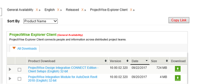

Can you send a link to this download as I can't find it on
Hi Greg,
The Revit 2018 Advanced Integration module is a separate add-in module for ProjectWise Design integration Update 2.3.  It will be merged into the PW Explorer installer in the next release.  To find it in the downloads page, remove the default filter on that page for CONNECT Edition and search for "ProjectWise Explorer Client."  The Revit AI module will be second in the list of results.
Regards,
Phil
