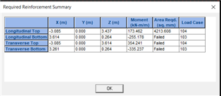

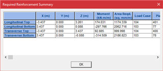

for the staad foundation advanced, under the Slab Designer and you click the 'Design', a table of Moments and Rebar Area Required appears. if it says 'Failed' in Area required, do I need to increase the thickness? Kindly elaborate more on this. Thanks

Regarding your question on why such large steel areas are shown in the screenshot you attached, we need your model. Also, let us know what build of the program you are checking it with.

thanks for the reply Kris Sathia. I followed your instructions for the 0.5m thickness and below is what I got.....

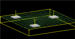

this is the meshing after the run. Will it not affect the direction of the rebars?

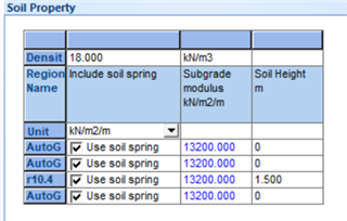

then I clicked the Soil Property and this what i saw...

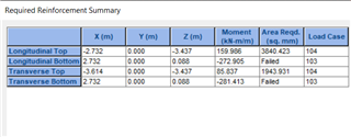

I changed the zero values with 1.5 and analyze then I got the following result....
'Failed' is still appearing and now 3 are failed from previous 2. I was expecting not to see 'failed'...

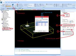

Here are a few suggestions.
1) Edit the job and remove the primary load cases 1, 2 and 3 from the Selected Load cases list. Thus, the analysis and design should be just for cases 101 to 104, 201 and 202.
2) The screenshot of the "Required Reinforcement Summary" that you attached earlier indicates that 3 of the 4 locations - Long Bot, Trans Top and Trans Bot - are within the perimeter of the columns. The program is supposed to ignore points beneath columns but versions prior to 9.6 had a defect that caused such points to be designed. The "What's New" section for version 9.6 mentions this.
Upgrading to 9.6.1.74 is the logical answer. But if you cannot do that, try the following:
In the Meshing Setup page, there is an option known as "Auto Generate Control Regions for Columns". It will create regions each having the same dimension as the perimeter of the columns.
Select each of them one at a time, edit, and switch off the option called "Design Control Regions".
Re-mesh the mat. Re-analyze. Then perform the design again. It should ignore the points beneath the columns and the 0.5m thickness should pass.

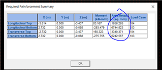

Really? working with 9.6? I'm currently using version 9.3. May I know the moments that you got with 0.55m and 0.5m thickness? just want to know the difference between the two versions. TIA. This is wat I got with 0.5m thkness.
It is found that in latest released SFA version 9.6.1.74 the attached file is being designed successfully with 0.5 m thickness without any failure. Please let us know the SFA version number you are using.

Btw, just want to verify if the moments computed by version 9.3 higher than the moments computed by version 9.6?
Also, the rebar areas that I got from version 9.3 are quite higher that if i compute it manually using the formula you've given above. Is version 9.6 giving an accurate rebars areas required? TIA.
It does appear that the slab design results are incorrect.
There were 3 releases of SFA since version 9.3. Over that period, all the errors reported by users and ones found by our internal testing in mat foundations have been corrected.
I would urge you to upgrade to the latest - 9.6.1.74. We have tested the results produced by this version for your model and are confident that they are correct.

Meshing does not affect the direction of rebars. If you look in the Moment Envelope generation page, you will find the terms Longitudinal and Transverse, and those are defined over there as along global X and along global Z by default. After the analysis, when you generate the moment envelope, the program calculates the bending moments that are aligned with those directions. Reinforcement is calculated for those Long and Trans directions.

In the soil property page, it is best to leave the soil height as zero for Auto-generated regions. Those regions represent space occupied by columns, so it is not possible for soil to occupy that space, hence the reason for assigning a height of 0.
