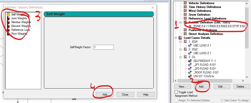

Hi, I recently just started using staad and this error message "   NO LOADING DEFINED FOR UBC LOAD. RUN TERMINATED." is shown. Can you suggest some solutions?
Thank you! :)

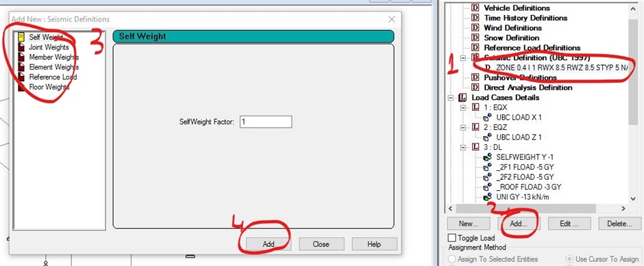

Accepted Solution
Hi Erx,
I have reviewed you model and found missing WEIGHTS in Seismic definition hence this error is displayed and the run is terminated as the program is unable to calculate for the seismic load. I have attached a picture showing the steps you need to follow to solve your problem.
14 Replies ( Latest reply by
Hi Erx,
woaah thank you very much this really helps alot, I really appreciate it :)
Thanks a lot for your kind response.
I have the same problem. I already put a self weigh on my seismic definition but still, it is not working. whyyyyy
Can you please upload the file here?
how can i rectify ?

Noted few issues
  • The DM parameter should be 0.05 and not 5
  • There was no seismic weight defined as part of the 1893 seismic load definition. I added the SELFWEIGHT for now. You may want to add any other load that you would like to consider for seismic weight calculation.
  • The seismic loads should be specified ahead of all other cases. So moved the cases 9 to 12 ahead of case 1.
Had a very quick look at results and saw that the node 417 has almost 11 inches of vertical deflection under load case 4 as it does not have any support. You may want to check that.
A modified file is attached for your reference communities.bentley.com/.../5100.Structure1.STD
Dear Sir,
how can you move the seismic loads to first ? & what is DM Paramater and how to modify that  value ?
what type of extra loads may be add in seismic definition ?
You can use the editor ( input command file ) to move the commands. The DM represents damping. 5% damping should be entered as 0.05. Please refer to the help documentation for details. You may choose to add your dead load (other than selfweight) plus a certain percentage of live load as recommended by your local building code.
