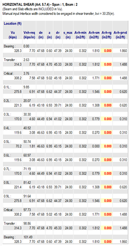

In LBC, prestressed girder, the horizontal shear report has all zeros under Avh_rg and they are red.  Everything else seems to check out, Avh_provided is greater than Avh_min, and we do have an intentionally roughened girder so I don't even look at Avh_sm.  But because the numbers are red, it looks like something doesn't check out.  Is there actually an issue that I am missing, or is this just a quirk of the program?image

Also a bug/Defect has been raised in our system to get rid of the red flag and there will be changes done to output table in the future versions.
