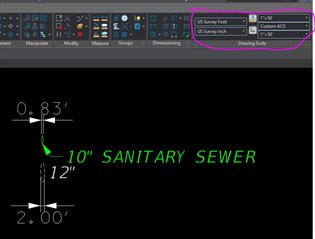

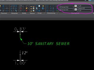

I had created the utility cells a while back and made them Annotation Cells. The cells are pretty basic. They are typically a circle or ellipse and a note (text with leader). The note is placed with Annotation Scale enabled. Text Height & Width are set at 0.01. The circular/elliptical element is placed at the the proper size (in the screenshot the 10" SS ellipse measures 0.83' wide and is exaggerated 5 times for a profile).
When this cell is placed in a profile with the annotation scale set at 1"=25' or 1"=50' (our typical scales for the profiles) the elliptical element remains the same size, but the text is scaled appropriately.

I had to go back to the cell library and scale the ellipse down. Now placing that cell in a profile with the Annotation Scale set at 1"=25' the ellipse is the correct size, but if this same cell is placed in a file with Annotation Scale set at 1"=50' the ellipse is scaled up 2 times larger than required. The text scales correctly in both drawings.
