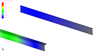

Hi,
I am writing because I need to verify Unsymmetrical Plate Girders with AISC 2010 and I do not why I have very high Unity Ratio under Lateral Torsional Buckling when I increase the Upper Flange width
in the picture you can see the same beam, with same loads. the only difference is the upper flange width. I do not why the beam with less material has lower Unity Ratios.
I have knowledge of the fact that:
- SACS provides an Allowable Stress, with some adjustments, no matter the code
- for Unsymmetrical Plate Girders, the Plastic Neutral Axis shall be at the level of the web
- AISC 2010 introduced significant modifications to the check of LTB and the formulas include the different inertia properties of the flanges
the problem is that the difference of Unity Ratio is sometimes very very high. Please see the model below and let me know.
thank you for your support.

according to my check with AISC 14TH F4-2, the reason you get quite different UC results while increasing top flange width, is that the top flange you increased is too wide, which makes the inertial moment of flange about minor axis in compression (bottom flange) is less than 0.23 inertial moment of shape about minor axis. this will make J=0 according to equation F4-5, which make the allowable stress decrease sharply.
