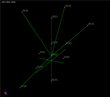

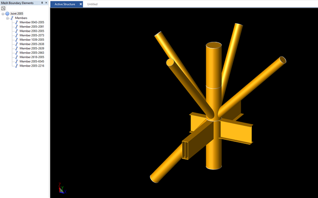

hello everyone, I have a problem modeling the joint mesher in my model below.
there is an error message like this

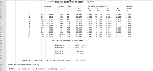

*** ERROR CREATING LOOP 6 OF 12 FOR MEMBER NUMBER 1 (2005-6545)
Joint not meshed successfully
* ERROR - An error occurred during loop decomposition
Can anyone help me with what this problem is caused by? how to solve this problem? thanks

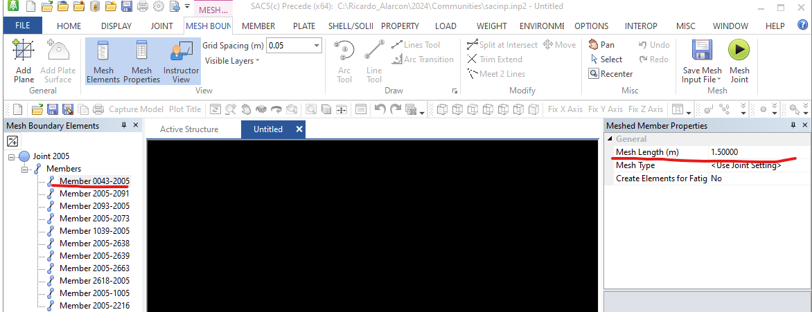

Seem that the length setting to each elements is not enoguth to mesh, please try to selec each element and set the length for each one,

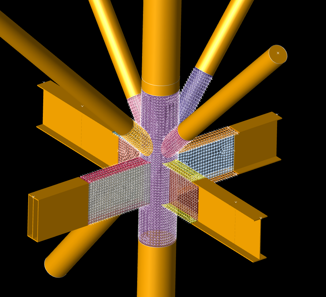

once you finish to set all dimensions in elements you will be able to mesh all connection, it's possible that you have problem to mesh the members 2005-2091 and 2093-2005, we need to ensure of provide to SACS a minimum of 2 times Hight of transversal section as a length to mesh, this is as a good practice.
actually, you have a length of 1 meter in each elements an seem that this is not enough to mesh the element, but if you increase this to 2 meters you will be able to mesh it
