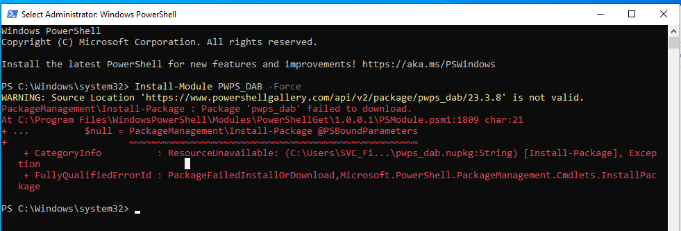

I am getting the below error on a new server when installing the module PWPS_DAB,  PS gallery is already a trusted one. Default repositry is PSGallery only. Anyone has any idea or any other settings needed to install this,

There is something on your system or network blocking you from accessing the powershell gallery. Try putting the URL it lists for the Source Location in your browser, when I did this it downloaded the pwps_dab nupkg file.
