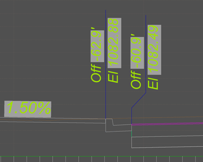

Has anybody come up with a way to prevent the stacking (or bunching) of Cross Section Annotations in the Annotation Group Settings? One way I have used in the past is setting specific ITL points within the Annotation Group to label, but that only works for that one project/group of cross sections. The other idea I had was to put a bend (and an offset) in the annotation callout and leader to offset that point from being places on top of an adjoining point, but have not tested this yet.
image image
Above are screen shots for what I am referring to that I did manually. If anybody has any thoughts on how to do this in the Annotation Group Setup, please let me know your thoughts. Please and thank you!

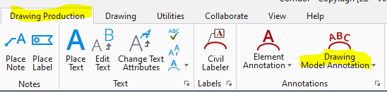

Step 2: Open a Drawing Model of one of the created sections, select the Drawing Production tab's "Drawing Annotation" tool, enable the All Drawing Models check box (pictured below) to add labels from an Annotation Group set to ONLY annotate the LT and RT using an Annotation Group filters that finds the EOP LT and RT (each will need a respective Annotation Definition added to this Annotation Group.  These two Definitions will contain a filter and Label Cell (w/ the text fav) that shifts the label as shown in the desired image with bent annotations.

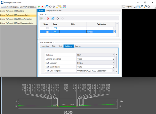

Frame annotation can be used with the collision settings to bend the leaders and annotate the drawing models.
