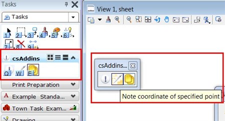

1. 在MyAddins.cs开头确保有如下两行using语句,然后修改Run方法内容如下。这样能保证我们一装载csAddins.dll程序集就能出现如上一章第9步所示的工具栏。
1. Make sure you have the below two lines at the beginning of MyAddins.cs, then modify the Run method as following. This can bring out the toolbox shown in the step 9 of last chapter as soon as you load our assembly csAddins.dll.

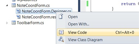

2. 如下图所示以代码方式打开NoteCoordForm.Desinger.cs文件,翻到代码尾部,将几个控件的声明由private改成public。修改后的代码段如下。之所以要进行这种修改是因为我们要在随后的其他类代码中访问这些public成员变量。这些成员变量的值反映了用户界面的操作结果。
2. Open file NoteCoordForm.Desinger.cs with code mode shown as below picture. Scroll to the end of the code; change some controls’ modifier from private to public. The finished code should display as following. The reason why we make this change is we need access these public member variables out of their classes. The value of these member variables denotes the operation result of GUI.

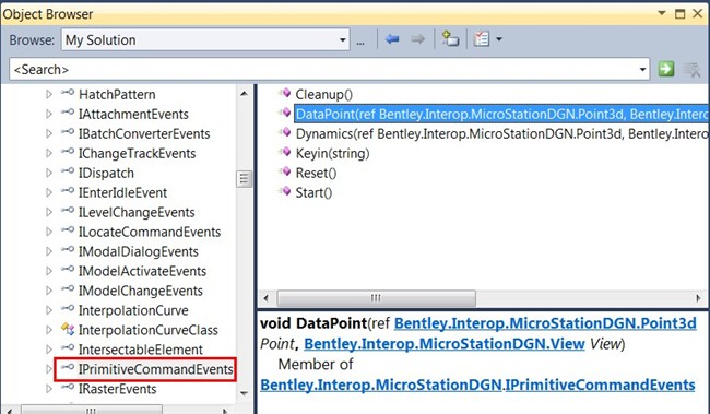

5. 为了实现动态标注指定点坐标的功能,我们需要在DemoForm.cs中添加一个实现IPrimitiveCommandEvents接口的新类,该类的名字叫做NoteCoordClass,类代码如下。您可以复制并粘贴这段代码到您的DemoForm.cs中或自己输入。该类必须重写Cleanup、DataPoint、Dynamics、Keyin、Reset和Start六个方法。这些方法的具体含义请参考Mstn VBA帮助文档。这些方法的原型可以通过VS的对象浏览器得到,如下图所示:
5. To implement the dynamic placement of identified point coordinate, we need to add a new class into DemoForm.cs. We name this new class NoteCoordClass which derived from interface IPrimitiveCommandEvents. The code of this class is as below. You can copy and paste it into your DemoForm.cs or type it by yourself. This class must overwrite 6 methods: Cleanup, DataPoint, Dynamics, Keyin, Reset and Start. Please refer to the Mstn VBA help documentation for the detailed information of these methods. You can also get the prototype of these methods in Addins by VS object brower shown as below picture.

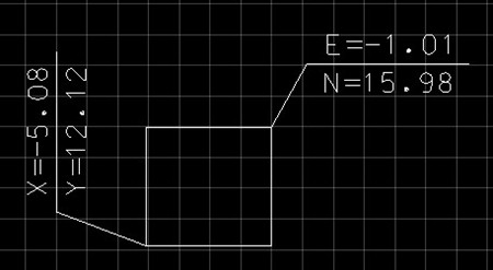

8. 生成您的csAddins并进行测试。在一个二维模型中事先绘制一个正方形,装载csAddins后点击工具栏中的第三个图标,选择某个角点后会拖出一个动态的标注线和指定点坐标文字,再点击一点确定标注位置。生成的两个标注如下图所示:
8. Build your csAddins and test it. You can firstly place a square in a 2D design model, then load csAddins and click the third tool in our csAddins toolbox. By selecting a corner of this square you will see a note line and two coordinate texts displayed dynamically. Identify another point to place the note into design model. The two notes are shown as below picture.

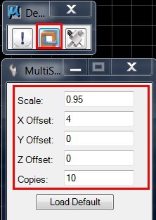

点击第二个工具图标,如下图所示设置工具框中的参数,选择这个正方形并确认即可生成如下图所示的复制结果。
Click the second tool and set the parameters as the following dialog shown. Select this square and accept, you will see the below created drawings.

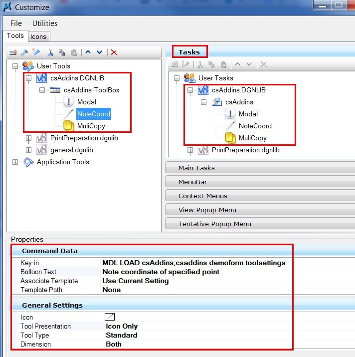

其实,Mstn提供有不需要编程定制界面的功能。这些定制的界面会被保存到一个叫做.DGNLIB的文件中,只要该DGNLIB文件位于Mstn的配置变量MS_DGNLIBLIST或MS_GUIDGNLIBLIST指到的某个目录下,则Mstn启动时就会加载该DGNLIB文件。通过打开该DGNLIB并选择菜单Workspace > Customize可以实现这种定制。由于本系列博客不是讨论Mstn的定制的,所以这里仅仅是提及而已。下图是定制界面以及定制出的效果。
Actually, Mstn has provided us the approach to customize GUI without programming. The customized GUI can be saved in a file which extension is .DGNLIB. If this DGNLIB file is located under the folders pointed by configuration variable MS_DGNLIBLIST or MS_GUIDGNLIBLIST, it will be loaded when Mstn starts. The customization work can be done by opening this DGNLIB file and selecting the main menu Workspace > Customize. We don’t dig into this topic deeply because this blog series aren’t focused on the customization of Mstn. The following pictures are the customization graphic interface and the result of my customization.
您可以下载如下附件csAddins.dgnlib到MS_DGNLIBLIST指向的某个文件夹下,重启Mstn后就能看到以上定制出的效果了。
You can download the below attachment and put it under a folder which is contained in your MS_DGNLIBLIST. Restart your Mstn then you will see the above effect.
