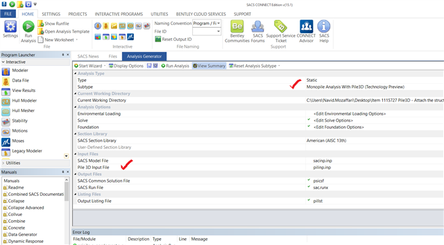

1.7.1     Pile Structure Interaction
Pile 3D has been extended to read reactions of structure at the mudline and apply them as pilehead loading for an unlimited number of load conditions. With this feature, users can perform monopile analyses suitable for Wind turbine design. To use this feature, a new type of analysis can be chosen via the analysis generator in SACS Executive with the SACS model file and Pile3D input file as input as shown in the figure.

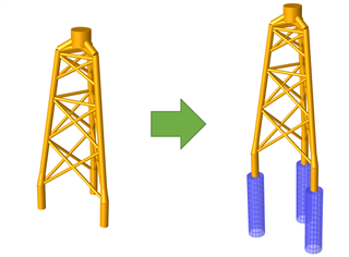

1.8    SACS Suction Bucket
The SACS Suction Bucket program generates a SACS model for the analysis and design of offshore structures with a suction bucket foundation. The bucket model is automatically generated using plate elements and the nonlinear interaction between the suction bucket walls and surrounding soil is modeled by a series of nonlinear springs. The nonlinear springs are automatically generated through the SACS-PLAXIS Suction Bucket Analysis Interoperability functionality.
The following are the highlights of the program features:

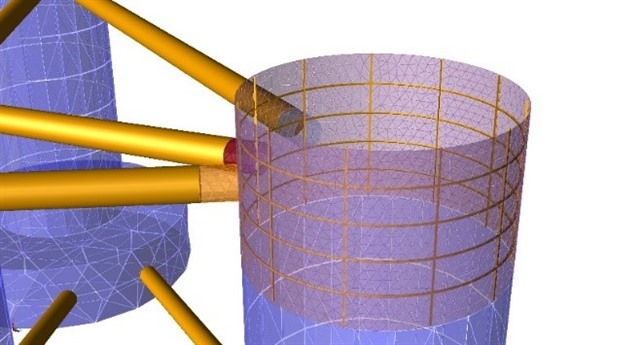

Advanced meshing tool to automatically generate the suction bucket model. The Suction Bucket program can also automatically include the ring and longitudinal stiffeners in the suction buckets using a series of simple input lines.

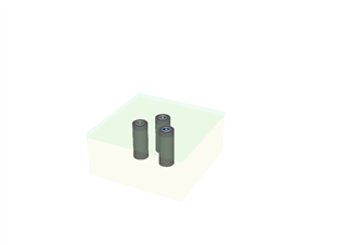

The SACS-PLAXIS Suction Bucket Analysis Interoperability automatically imports the SACS suction bucket model, the jacket stiffness, and the applied loads using superelement into the PLAXIS 3D program to analyze the soil-bucket nonlinear interaction.
Automatically generate nonlinear soils by fitting multilinear curves on the PLAXIS 3D stress results.
The final suction bucket model is ready to use for any type of analysis in SACS including static and dynamic analysis, and ultimately post-processing to calculate stresses and code checks.

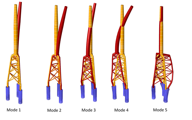

Modal Analysis:
