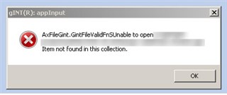

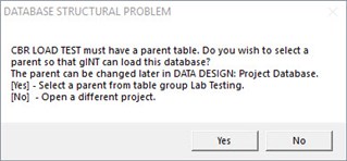

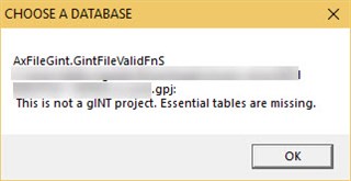

Errors received include:
Error 3343: Unrecognized database format
DatabaseAx.DBCloneFnB: DAO.Database: Unrecognized database format…
Database Structural Problem error
AxfilegINT.gINTfilevalidFNS errors:

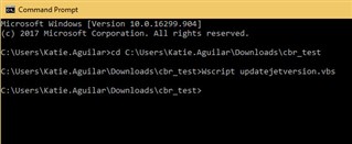

  5. Start the command prompt
  6. At the command prompt, navigate to the folder where the script is located
    1. If you are unfamiliar with changing directories, you do this by typing in cd followed by the directly path at the command prompt. For example: cd C:\Users\Public\Documents
  7. At the command prompt type: Wscript updatejetversion.vbs
    1. image
  8. The script will run. If you return to the folder where you saved the new project, open the project using gINT.
