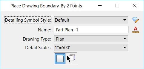

  3. Open the Place Drawing Boundary tool. (Drawing>Annotate>Detailing>Place Drawing Boundary).
  4. In the Place Drawing Boundary tool settings window, make the following settings:
    You are prompted to define the first corner of the drawing boundary.
  5. Issue the first data point in the upper left corner of the border and the second data point at the lower right corner of the border.

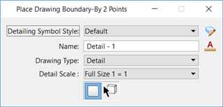

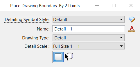

  2. Open the Place Drawing Boundary tool setting. (Drawing>Annotate>Detailing>Place Drawing Boundary).
  3. Make the following settings in the tool settings window:
  4. Snap to the top left corner of the first section and enter a data point to define the first corner of the Drawing boundary.
  5. Snap to the bottom left corner of the first section and enter another data point to define the second corner of the drawing boundary.
  6. Next, enter a data point to place the annotation.
