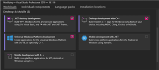

MicroStation SDK native (C/C++) and managed code (.NET add ins) development requires:
Bentley Visual Studio Templates
Microsoft Visual Studio Configuration Recommendations
Visual Studio - Workload Dependencies
  • .NET Desktop Development
  • Desktop development with C++ (Provides: DIA SDK)
  • Universal Windows Platform development (Provides: Windows 10 SDK, or Download)
