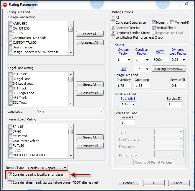

QUESTION: How to check the Rating at the Bearing location for Shear ?
ANSWER:
There were cases where in some users wanted the Ratings to be shown at the bearing location for Shear. There were cases where in the users did not wanted to show the Ratings at the bearing location for shear . Just to avoid conflict a new option has been provided in V15 Connect edition-- Rating Parameter dialog box.If the user wants to see the Rating in the output then he/she needs to CHECK  " Consider Bearing locations for Shear" option and if they don't  want to see the rating in the output then he/she needs to UNCHECK the option. This option is available for both Report Type "Basic Report" & " Florida DOT Report" .
Please see the attached Screenshot for more information.
