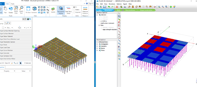

The iTwin Analytical Synchronizer (iTAS, formerly known as ISM or Integrated Structural modeler) allows users to publish a structural model created in, for example STAAD.Pro, as a *.ism.dgn file. The file can then be imported into other Bentley structural modelling applications to quickly reuse the structural model geometry and assigned materials and update any changes to the design in the external *.ism.dgn again.
With the ISM functionality in the PLAXIS 3D interface the structure’s geometry and materials can be imported into a PLAXIS 3D model, to combine it with the subsurface for a geotechnical analysis including the full structure.
Note that the ISM functionality in PLAXIS 3D will already not work with iTwin Analytical Synchronizer 2023 (23.00.00.092) and later. With an upcoming major release, the ISM import and publish functionality will be entirely removed from the PLAXIS 3D interface. Note that this change is strictly limited to just PLAXIS 3D, none of the other Bentley applications, nor iTAS itself are affected by this change.

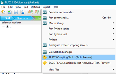

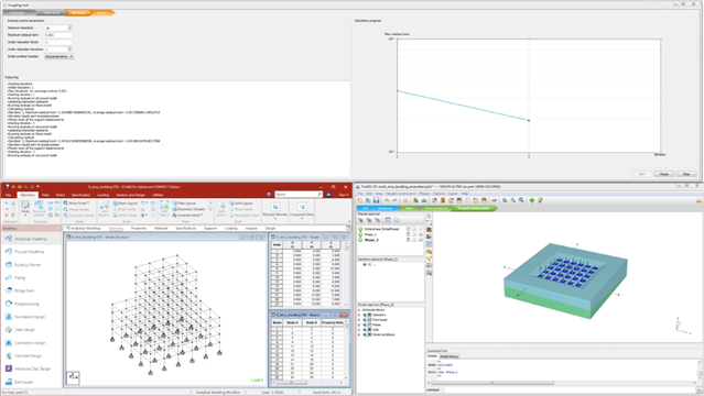

PLAXIS Structural Coupling tool with STAAD.Pro
Updated February 2024
The PLAXIS Structural coupling that works together with STAAD.Pro enables users to do an iterative coupled analysis between a structural model in STAAD.Pro and PLAXIS 3D, considering the full non-linear response of the soil. This is done by simulating the interaction of a particular structural load case, through point loads located on the soil in PLAXIS 3D, that correspond with the base of the structural model in STAAD.Pro. Resulting displacements and forces of the PLAXIS 3D analysis are then used to update the structural model's base restraints and reruns the loop between STAAD.Pro and PLAXIS 3D until convergence is reached in the coupling tool.
With the release of PLAXIS 3D 2023.2 the PLAXIS Coupling tool is deprecated and with an upcoming major release the PLAXIS Coupling tool will be entirely removed from the PLAXIS 3D interface.
