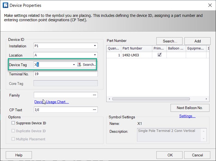

Changing the device ID of a terminal block on the Device Properties dialog may not change the device ID of all the other terminal blocks in the strip. Or it only changes the device ID of the other terminals if they are in line vertically with the terminal being renamed. In earlier versions of the software, changing the device ID in this many would change the terminal number to the next available number in the newly assigned strip. In Connect Refresh, the option to update all the terminals in the strip is presented when the device ID of one symbol is changed.

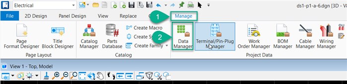

Open Terminal/Pin-Plug Manager.

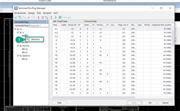

Right-click the name of the strip or plug and select "Rename".

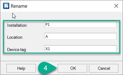

Rename the Installation, Location, or Device tag as desired.

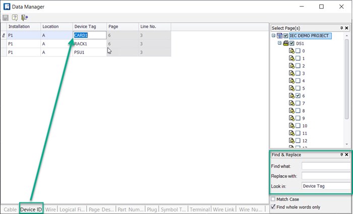

Open [[Data Manager]].
Select the Device ID tab. The results can be filtered by clicking the filter symbol in the upper right of any column header.
Change the Installation, Location, or Device tag values as desired. If multiple rows are selected, a change to one row will propagate to the other selected rows. The Find & Replace pane can also be used.
