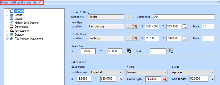

  2. Go to Settings –-> Settings
  3. Settings dialog will pop up labeling “Project Settings [Project Name]

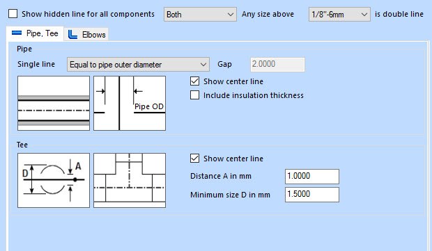

  4. Go to “Hidden Line Options”
  5. Hidden Line Options will be shown
  6. Check “Show hidden line for all components” box
  7. Save settings and close settings dialog

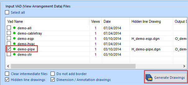

  8. Go to Drawing Generation –-> Generate
  9. Select a View Arrangement File and press “Generate Drawings”

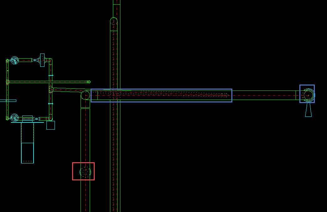

  10. Output drawing will be generated and user can see Hidden pipe line components in output drawing
