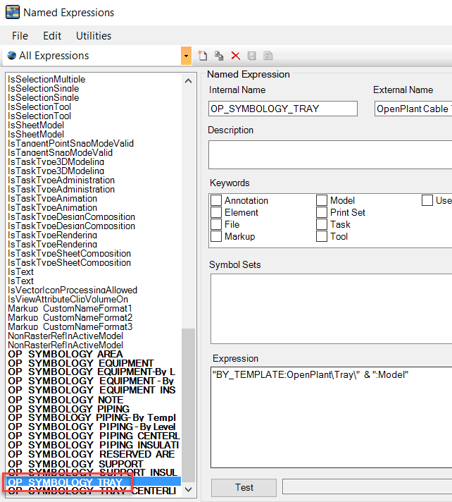

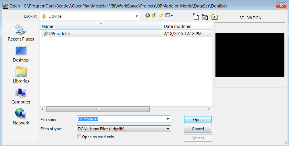

  1. Go to File from Main Menu option and open DGN library files (dgnlib). See image below :
  2. Under Utility Menu, Select Named expression and click on OP_SYMBOLOGY_TRAY. See image below for reference.

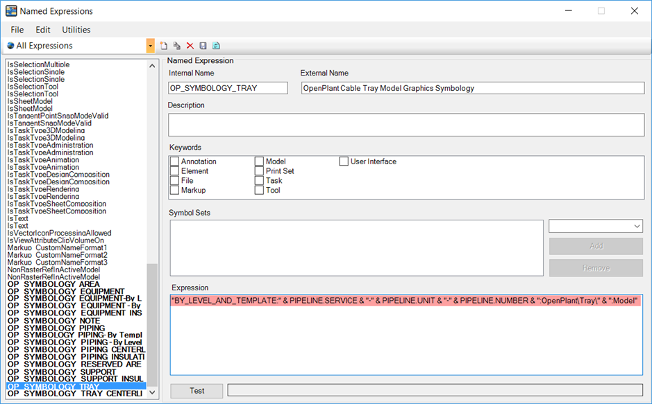

  3. Below are the Symbology pasted to copy from here and to get it pasted to the respective Expression of OP_SYMBOLOGY_TRAY:
    "BY_LEVEL_AND_TEMPLATE:" & PIPELINE.SERVICE & "-" & PIPELINE.UNIT & "-" & PIPELINE.NUMBER & ":OpenPlant\Tray\" & ":Model"
    See the image below for reference
    NOTE- You can change the sequence of unit, service and number not use all three as per requirement

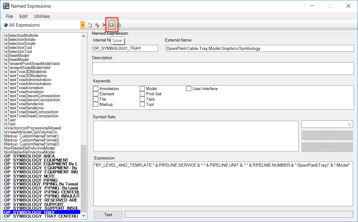

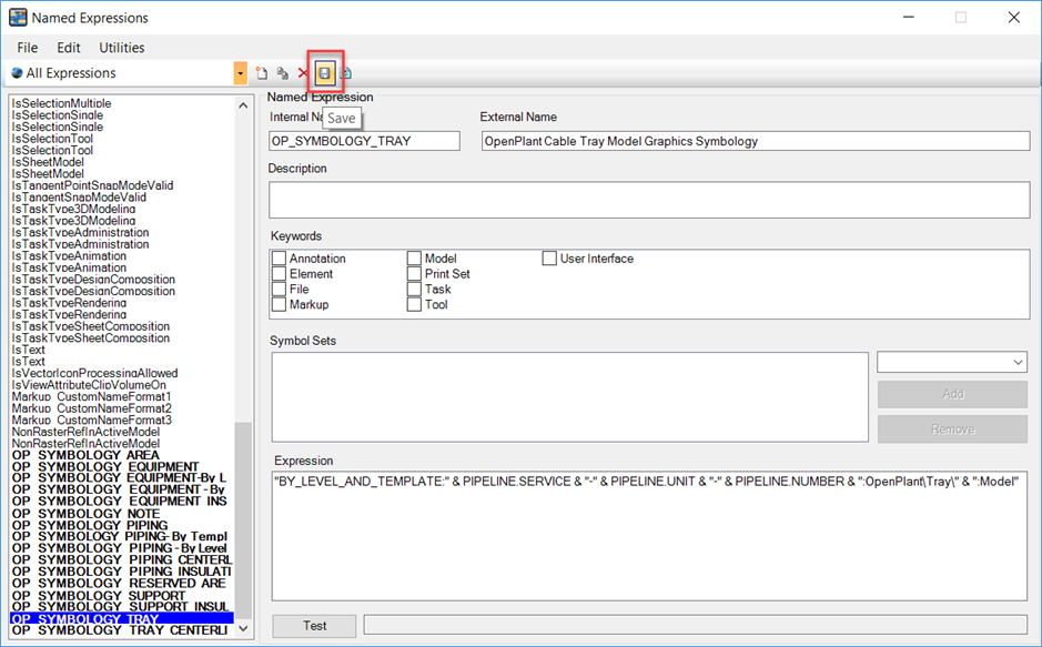

  4. Save the Expression which turns blue. Save option will get enabled once you modify the Expressions: See below for reference.

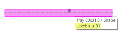

  5. Launch OpenPlant Modeler and Verify results. See images below:
Pipeline Level as 'TRAYLINE.SERVICE-TRAYLINE.UNIT-TRAYLINE.NUMER
