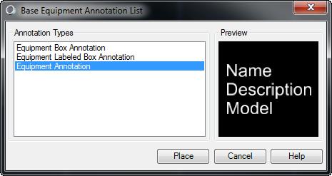

This article will explain how user can add their custom properties in the default equipment annotation and annotate it on the drawing.

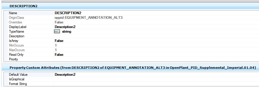

- Open class editor and load OpenPlant_PID schema supplemented with OpenPlant_PID_Supplemental_Imperial schema.
- Go to EQUIPMENT_ANNOTATION_ALT3 class.
- Add the custom property on this class. In this case DESCRIPTION2 property is added for example.

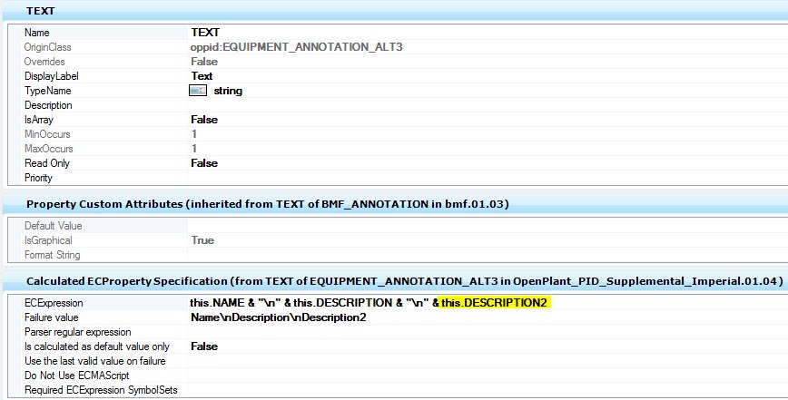

Note: Add the Property Custom Attribute and add the default value as shown above. This step is critical. - On the same class, locate TEXT property and replace MODEL with DESCRIPTION2 as shown below.
- Now save the changes in schema.

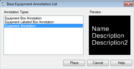

Verify the Result
- Launch OPPID and open a drawing.

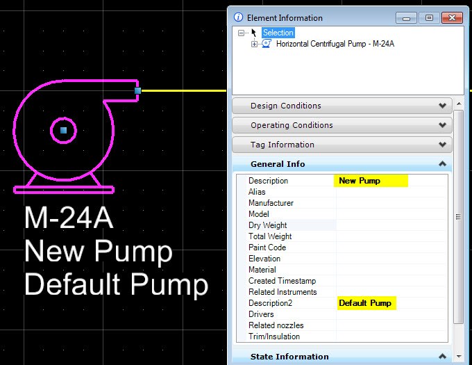

- Place an equipment and key-in the values for Description & Description2 properties.
- Select the annotation which we just modified.
- Hover the annotation over equipment and place it below the equipment.
