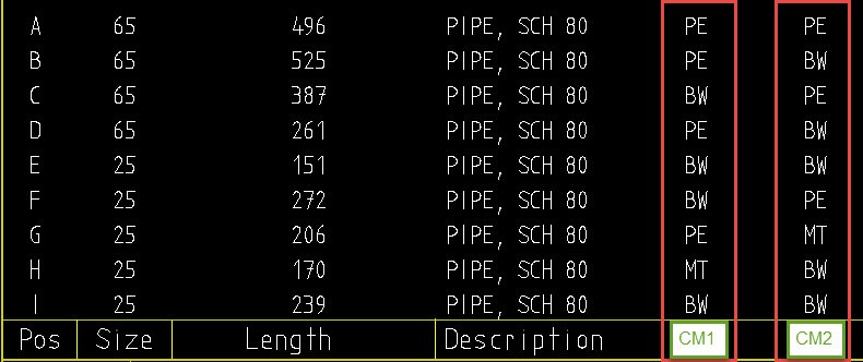

In AutoPLANT Modeler or OpenPlant Modeler's generated Isometric, spool ends type (SW, BW, PL, SCREWED) information is important for fabrication purpose. By default ends type information is not populated in Isometric cut list, but following steps will guide how to add end types in cut list.

- Open report.def file and add two new COLUMN entries to show "CM1" and "CM2" attributes.
# The CUT report lists the pipe cut pieces
# Attaches to text node 61
REPORT = CUT
INCLUDE = IE_TYPE=CT_PIPE|CT_BEND
COLUMN = 5:C:CUTID
COLUMN = 6:R:SIZE1
COLUMN = 16:R:QUANTITY
COLUMN = 10:R:
COLUMN = 20:W:IE_DESCRIPT
COLUMN = 10:W:CM1
COLUMN = 10:W:CM2
GROUP = CUTID
SORT = CUTID
NODE = 61
END
- Generate isometric and verify result.
