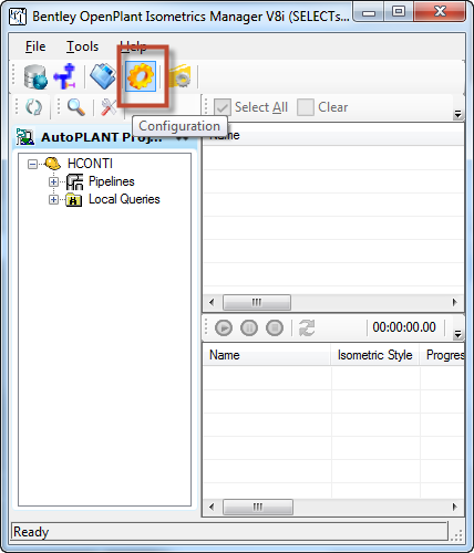

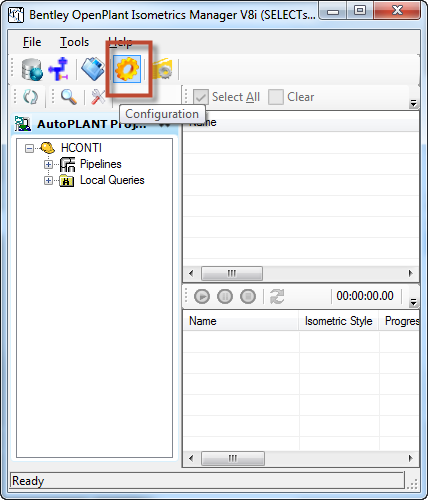

  1. Launch OpenPlant Isometrics Manager, to open Isometric Configuration dialog.

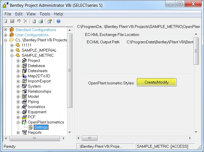

  2. Launch Project Administrator and browse working project  ->OpenPlant Isometrics->Settings->Create/Modify.See image below.
  3. For launching OUT-Session, click on icon and select Tools-> Configuration button on launch.

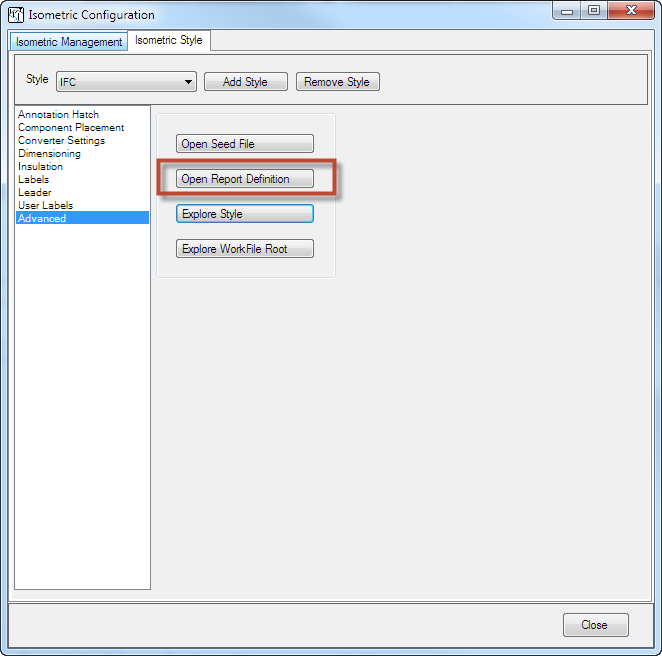

  4. Open Configuration manager. See image below.
  5. Go to "Advanced" option, click on "Report definition". It will open report definition file. See image below:
    Note: User can also navigate through the project folder for report.def file. Below is the suggested path for user:
    C:\ProgramData\Bentley\Plant V8i\Bentley Plant V8i Projects\SAMPLE_METRIC\Config\OpenPlant \Isometrics \styles\IFC\config\report.def
  6. In report definition file add new definition to report.def file. See below:
