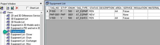

- Expand Views and select any View. Here, Equipment list View.

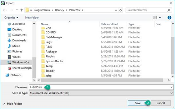

- Go to File-> Export, select Access , Excel and click OK.

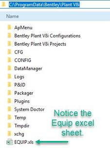

- Save your Excel Worksheet. (You can define path location to save this file), Here, we are saving it in Plant V8i.
- Select View from the list. Here, Equipment List, click OK and minimize Data Manager.
- Open saved excel sheet (EQUIP.xls)

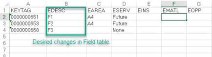

- Make changes in required field. Here we are defining changes in Description (EDESC) and save the file.
Note: Column name from Excel sheet should match with Data Manager Field

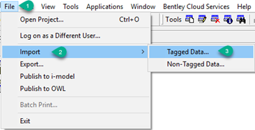

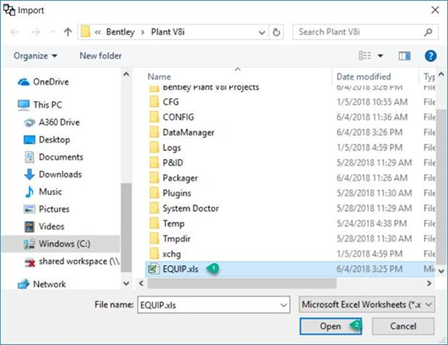

- Open Data Manager, go to File -> Import ->Tagged data and select Access, Excel
- Select EQUIP.xls from the location, select Open and click OK

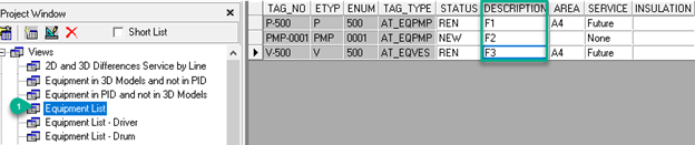

- Verify Description in Equipment List.
