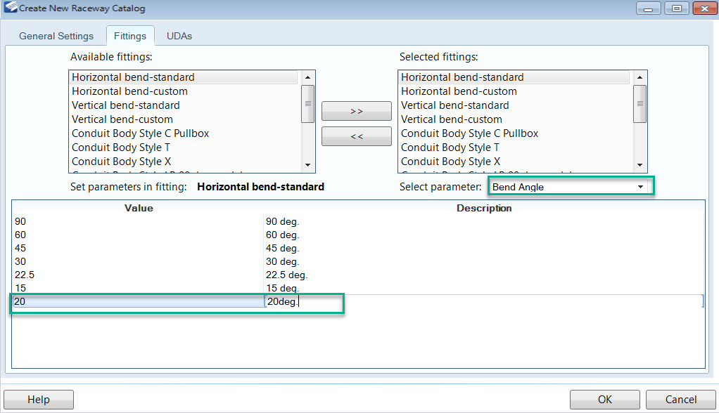

If you want to create custom fittings as per the design requirement, it could be done with the help of Raceway Catalog Creation Tool.

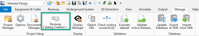

- Select Raceway Catalog Creation tool from the Manage ribbon tab.

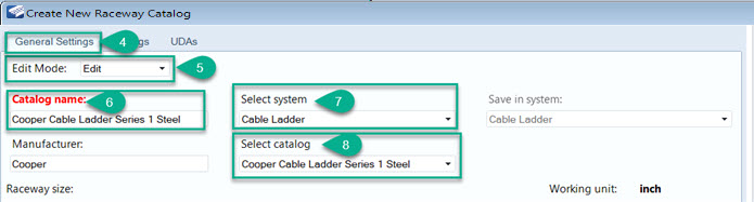

- Create New Raceway Catalog window pop-ups and there are tab General Setting, Fittings, UDAs.

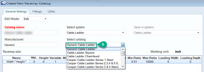

- In General Settings, change Edit Mode as Edit, select Catalog name (Copper Cable Ladder Series 1 Steel) then Select system (Cable tray Solid Bottom, Cable Ladder, Cable Basket, Conduits)

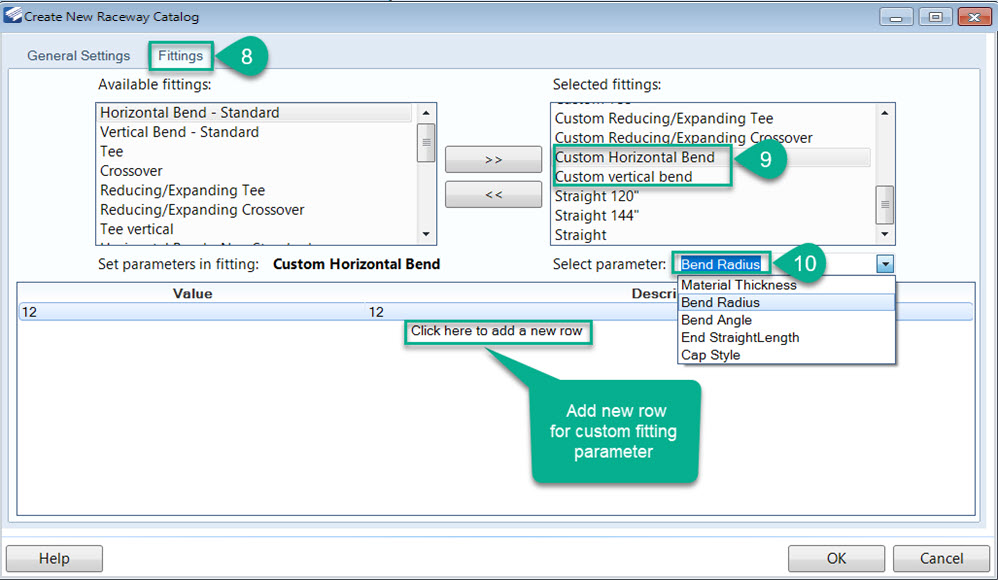

- In Fittings, there are Available fittings for selected raceway system in BRCM and Selected fitting are fitting customized according to the parameter that are mentioned.
- Click to add new row for adding parameter for selected raceway catalog.
- Add value and description for same parameter.

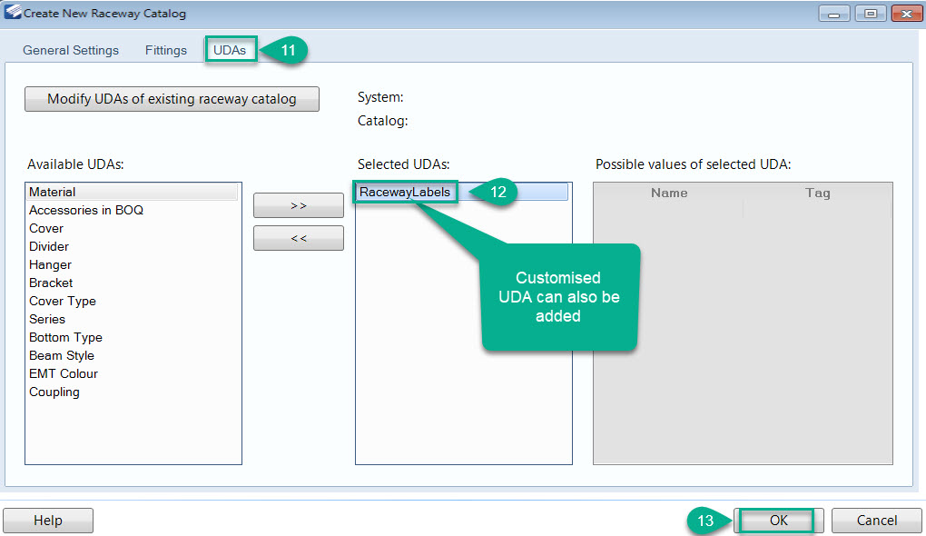

- IN UDA tab, you can add additional attributes for fitting as needed.
- Click OK.
NOTE: Before modifying this, make a backup copy of dataset.

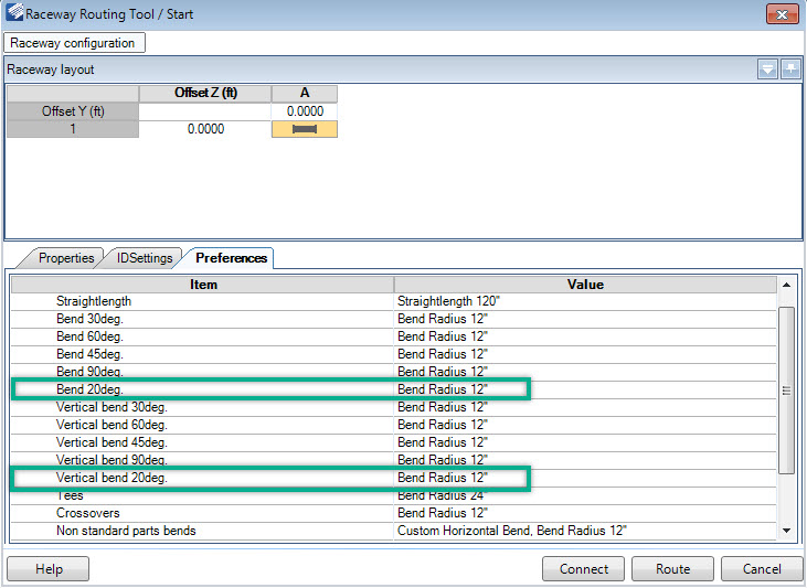

Verify Results: For Cooper Cable Ladder series 1 steel catalog, Bend 20deg. And vertical Bend 20 deg. is categorized. We can place its fitting by selecting Preference and Place Part.
