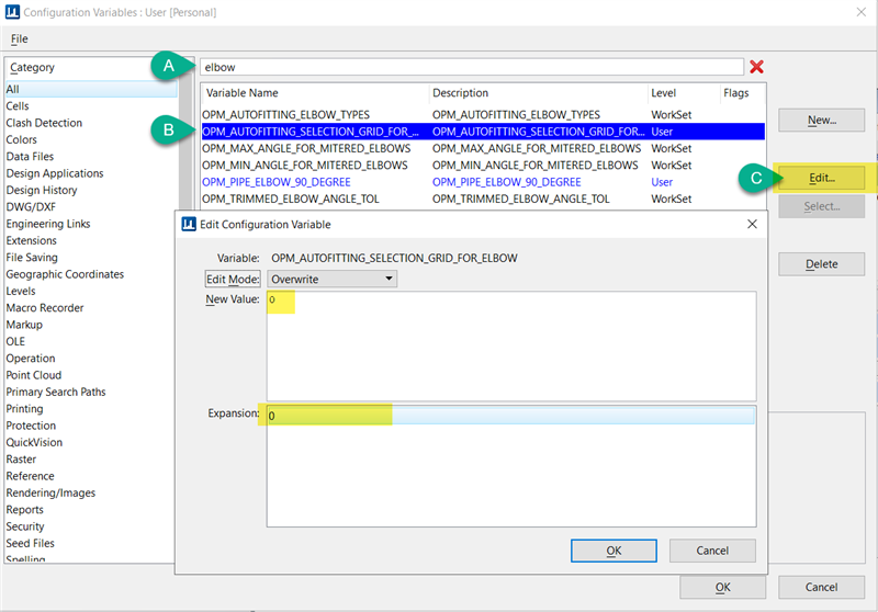

  1. Launch OpenPlant Modeler CE U9
  2. Consider OpenPlantMetric Workset, Go to Searh and type Configuration Variable.
    As soon as Configuration Variable window is launched, Type Elbow and select variable OPM_ AUTOFITTING _ SELECTION_GRID_FOR_ELBOW
    And which has been in default has been disabled i.e OPM_ AUTOFITTING _ SELECTION_GRID_FOR_ELBOW= 0.

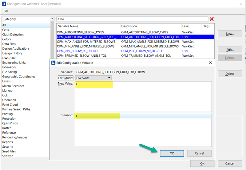

  3. Double click on 0 to edit  and make it 1 i.e OPM_ AUTOFITTING _ SELECTION_GRID_FOR_ELBOW= 1.
  4. After making the changes in Configuration Variable kindly restart OPM CE U9 and again place the Pipeline it can be notice that during placement of Elbow you will have the option of different type based on Grid window popped up.
    Note- If for a particular size there multiple records like for Long Radius available in spec then it would not work.
    Thus During piping modeling fitting wrt Elbow can be selected with required specification based on Grid Popped up through the new introduced variable.
