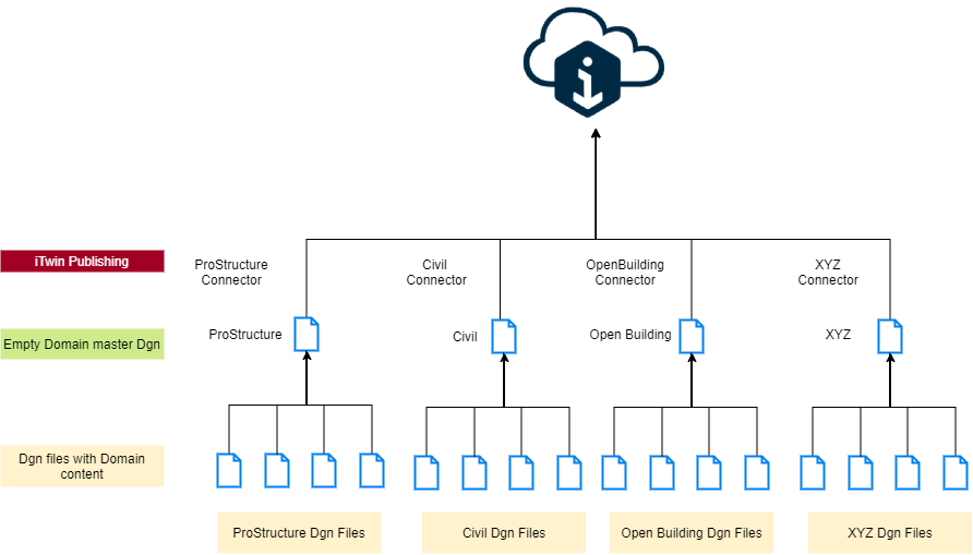

Selecting the Appropriate Connector
When synchronizing from the desktop, there is logic in place to figure out the correct connector for synchronization by looking into the meta data of the dgn and it is able to select the ProStructures connector for the dgn files with ProStructrure components even if these components are placed using Open Bridge Modeler or OpenPlant Modeler.
However, when creating a connection on the web this decision needs to be made explicitly by the user. The image below outlines a method to configure files so the connector can process them correctly. It is just a concept and you can modify based on your requirements to cater for deep nesting cases. This strategy can be used for desktop as well and will help desktop users to move to the web based workflows for the future.
