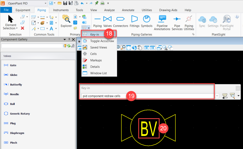

If user wishes to add Label/ text or add graphics to existing cell component, this Wiki will help to accomplish that. In this case we will do make changes in Valve

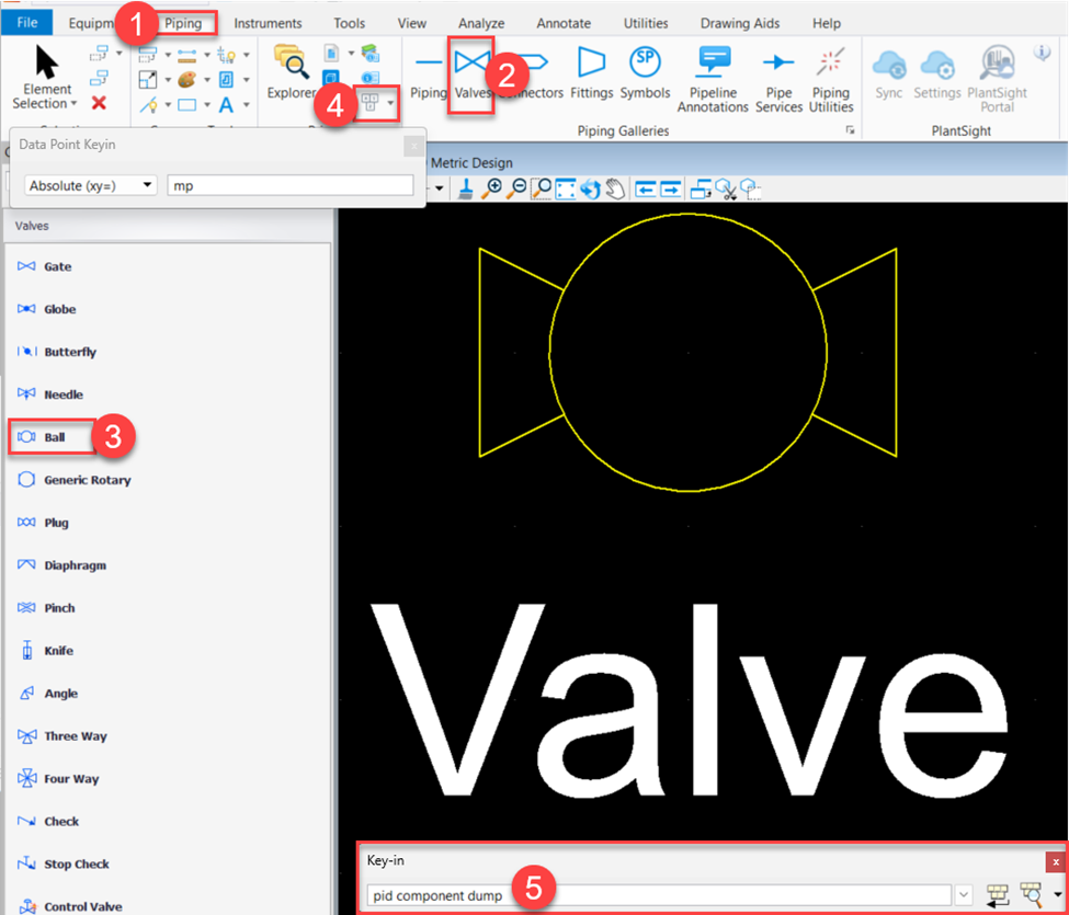

- Start OpenPlant PID CE
- Open .dgn file with concerned Workspace and Workset
- Place a Ball Valve
- Open Key In Browser, and type ‘’ pid component dump’’

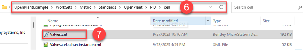

- Open Valve.cel file located at
C:\ProgramData\Bentley\OpenPlant CONNECT Edition\Configuration\WorkSpaces\Workspace\WorkSets\Workset\Standards\OpenPlant\PID\cell

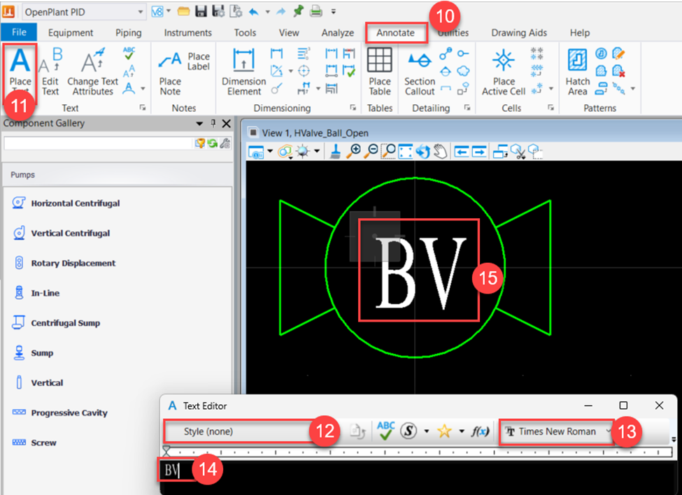

- Go to model and open Hvalve_BALL_Open
- Add Required Text/Graphics to cell

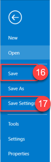

- Do save cell and save settings
- Go to Workfile dgn and run Key In Browser with command ‘’ pid component redraw cells’’, graphics of cell will be changed
