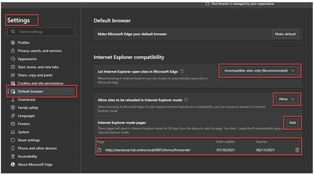

In order to run forms on Edge, go to Settings->Default browser and set the following as per the screenshot below.
Make sure you add your forms deployment URL in the [Internet mode pages] panel
