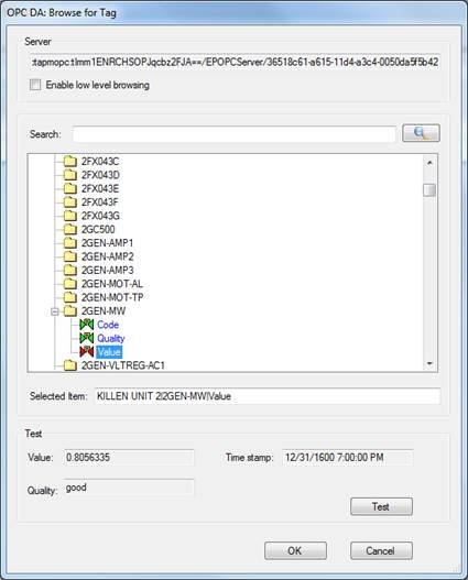

Timestamp 12/31/1600 returned when browsing an OPC DA tag
 Version(s):7.5
 Environment:N\A
 Area:N/A
 Subarea:N\A
When browsing an OPC DA tag in the APM Client, the time stamp displays the date as 12/31/1600 even though the prerequisite version is installed.
Installing OPC Core Components Redistributable (x64) version 106 fixed this problem.
However, note that the install of 105 has a much smaller footprint than 106, so may also have been do to some features not having been installed in 105.  This was not tested as installing version 106 fixed the problem.
This is the old version that didn’t work:
This is the version that does work:
