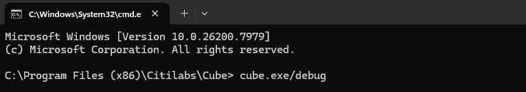

3. Launch CUBE with the debug flag
Run the following command:
cube.exe /debug
The screenshot below shows what this looks like in Command Prompt:
