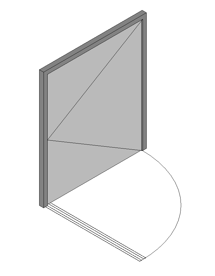

I need to modify existing PAZ door cells from the UK dataset to add rectangular 2D symbols representing zones where hardware might be installed, as shown in this image:
Those symbols should move with the door leaf itself.  I also would like to know whether it's possible to add an angle variable to show the 3D and/or 2D leaf symbols either open or closed.

Your door should look something like this:
Note: You can also link the 3D door leaf angle to the 2D symbol leaf angle so they are always in sync.  To do so, set the value of the variable Leaf1Angle3d to "=Leaf1Angle" and republish the PAZ if needed.
Below is how the door should behave using all of the steps above.
