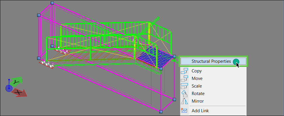

1. Right Click on the Stair Workframe and click on Structural Properties.

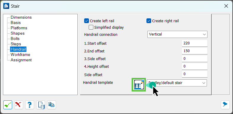

2. Select Handrail and click on the Edit Handrail Settings button.

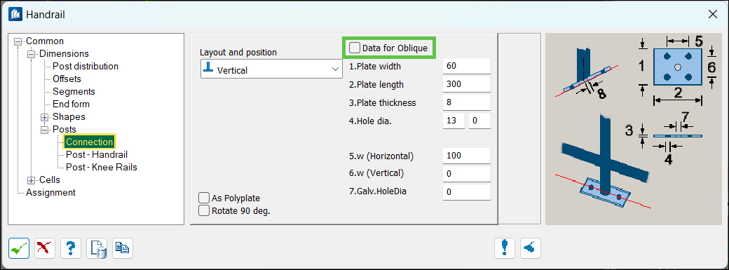

3. Under Connection, please uncheck Data for Oblique, this will now allow you to edit the dimensions.

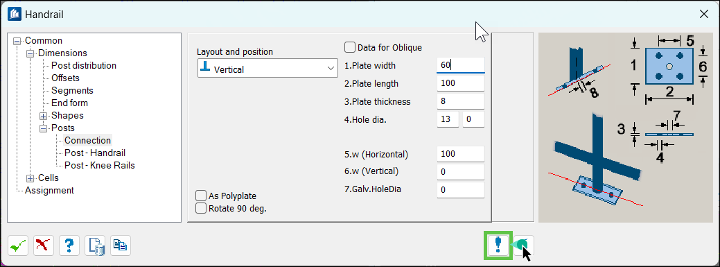

4. After entering required values then click on the Update History button to see effect.
5. Click OK to save the settings.
