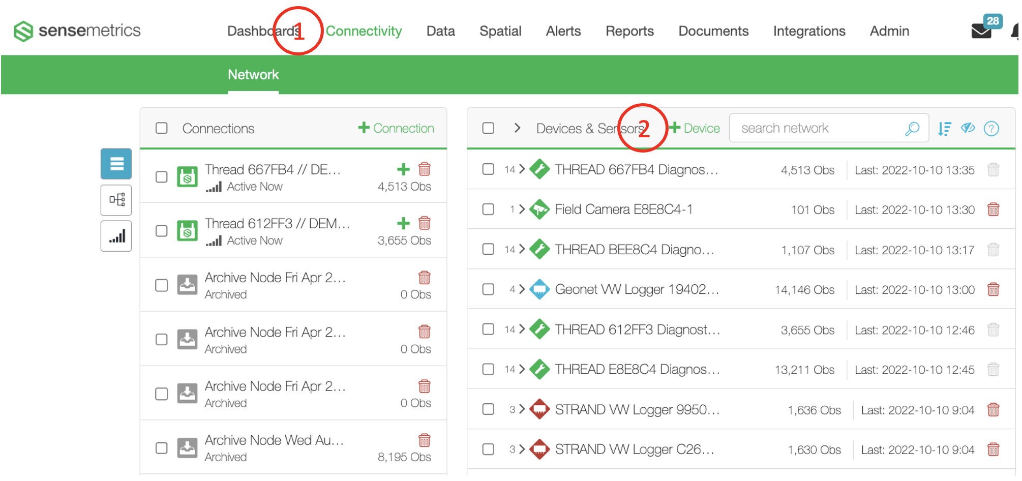

1. Navigate to the Connectivity tab.
2. Select +Add from the Devices & Sensors Menu.

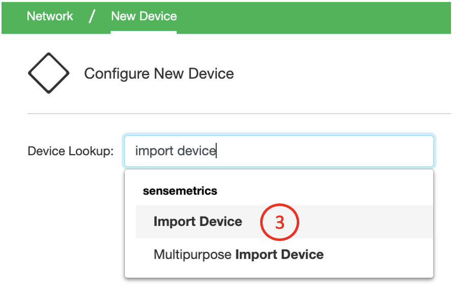

3. Begin typing "Import Devices"  into the search bar. Select "Import Device" from the drop-down options.

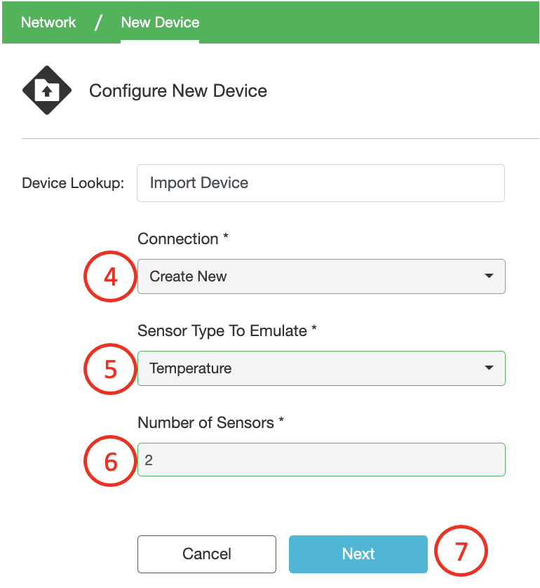

4. Select which Import Device you would like to add additional import sensors to on the project. If a new device is required for import, choose "Create New" to make a new virtual device connection if one already hasn't been made. The dropdown will also allow the user to select any previously created import device.
5. Select the sensor type to emulate. The dropdown options are listed below:
6. Select the number of sensors you would like to create under this device. The number selected will create that number of emulated sensors.
7. Click "Next" to save your settings.
