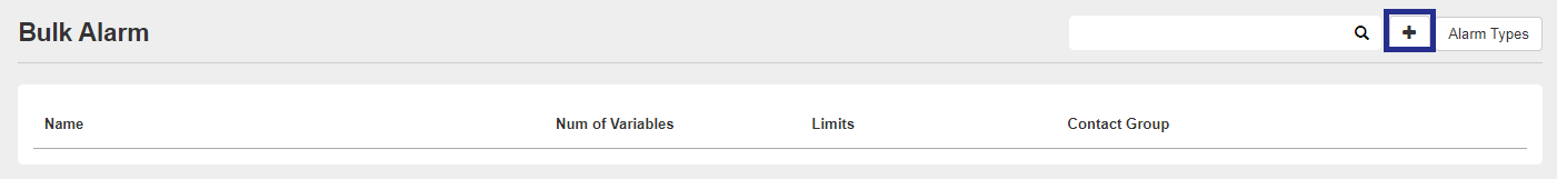

To configure a Bulk Alarm navigate to Setup → Bulk Alarm.
A list of all the current Bulk Alarms in the system will appear.

Adding a new Bulk Alarm
Navigate to the Bulk Alarm from Setup → Bulk Alarm.
Select the + symbol in the top
The main Bulk Alarm setup will show up on the left side of the screen. Check or un-check Time to have the alarm time-dependent or not, or check or un-check Skip Off Alarms to skip sending off alarm off reports.
Give the Bulk Alarm a name, assign a contact group, time, choose the time interval the alarm should be repeated on and if there should be a time delay to the alarm. It is also possible to add a description to the alarm on the box on the bottom.

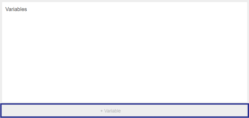

Adding Variables
On the right-hand side of the screen, the Limits and the Variables can be added to the Bulk Alarm.
Bellow the Limits box is the Variable assigner.
To Add alarms, click on the +Variable as seen above, and the VDV variable selector will open up, allowing the user to filter through sites to select what variables to assign to the Bulk Alarm.
