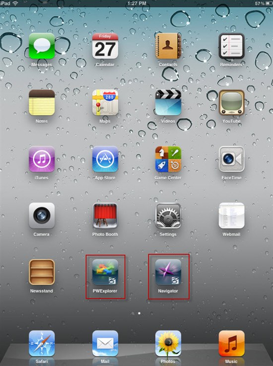

- Please install ProjectWise Explorer and Bentley Navigator via iTunes.Once installed you will see the PWExplorer Icon on your home screen. (SC1)
SC1

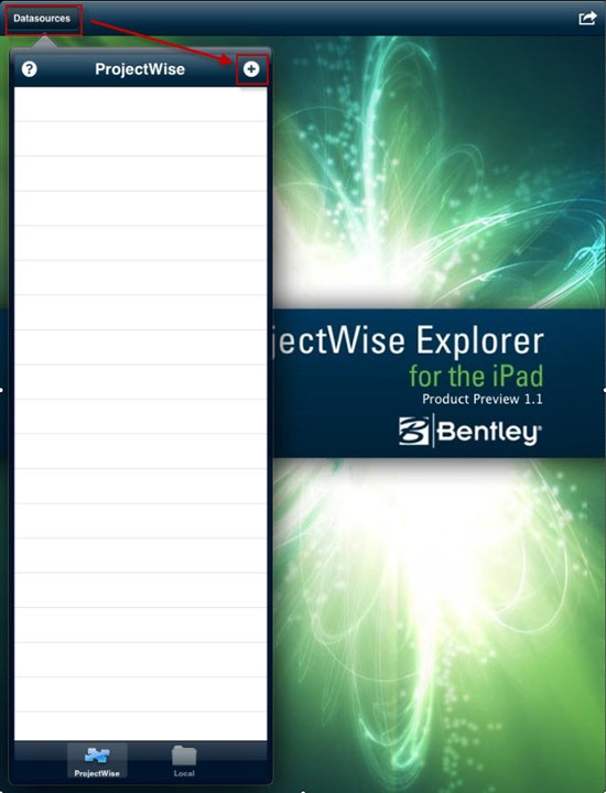

- Once ProjectWise Launches, click on the Datasource Button on the top left of the screen, then the + button in the ProjectWise Datasources drop down window. (SC3)
SC3

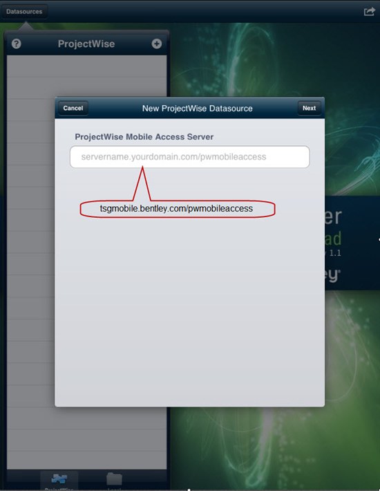

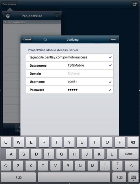

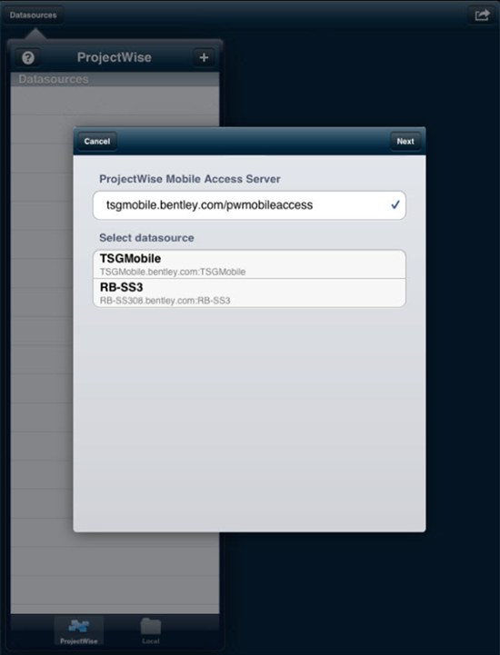

- In the 'New ProjectWise Datasource' window Under the ProjectWise ProjectWise web services field type in your ProjectWise web servicess FQDN ie. tsgmobile.bentley.com/pwmobileaccess. (SC4) On the top right hit Next.
SC4
- Any datasource that is registered under the Mobile Server with the FQDN will show in the 'Select datasource' list. Select the datasource you wish to login to ie. TSGMobile (SC5)
SC5
- After selecting the datasource enter the Username and Password and once the information is verified you will see check marks on the right has side (SC6 )
SC6

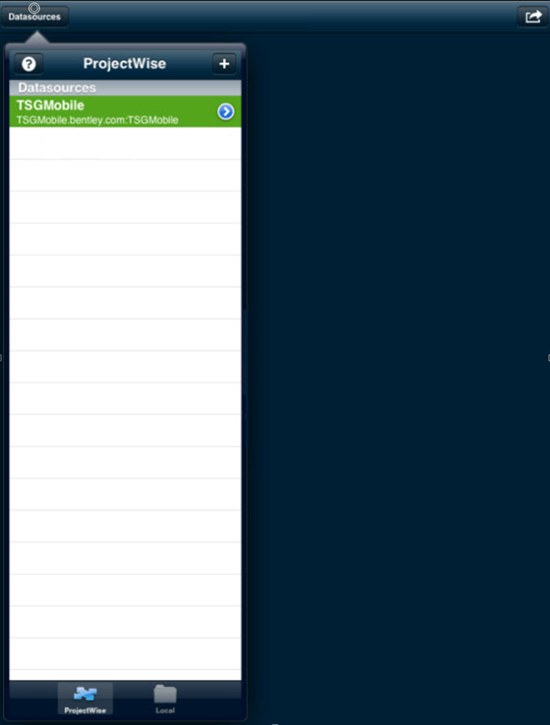

- Once the datasource is ready to be logged in it will appear in the Datasources list (SC7)
SC7

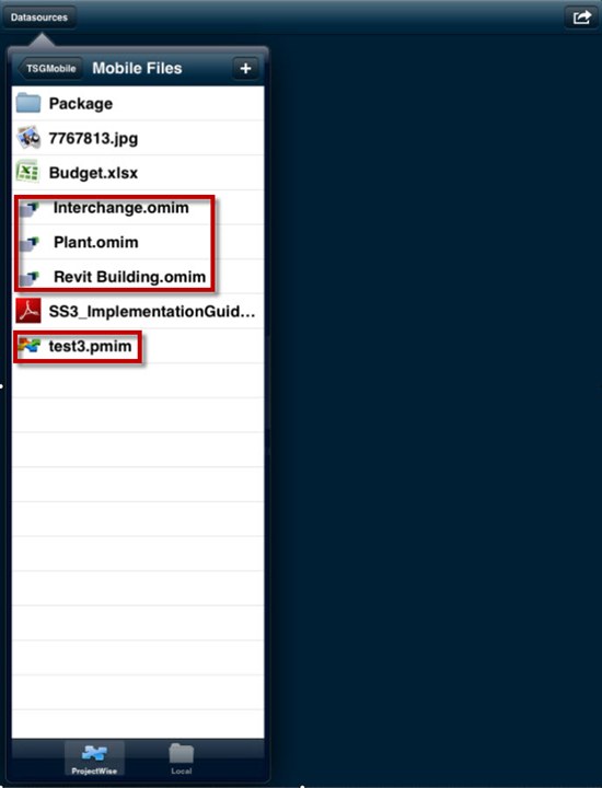

- Notice there are two different extension OMIM and PMIM These files types are used with iPad ProjectWise Client and iPad Bentley Navigator Applications. You can navigate to these two technotes to see how to create a PMIM and a OMIM file. (SC8)
SC8

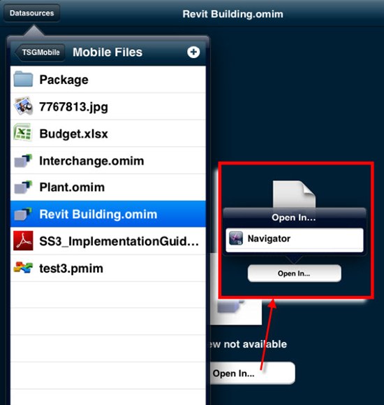

- When you click on a .jpg, .pdf, office file extensions, etc… on the iPad it opens in a application that its mime type on the iPad is associated to.For OMIM file and PMIM there are specific workflows. For a OMIM file once it is created via MicroStation, and uploaded in to ProjectWise. You will need to click on the file and view the document via Bentley Navigator.(SC9)
SC9

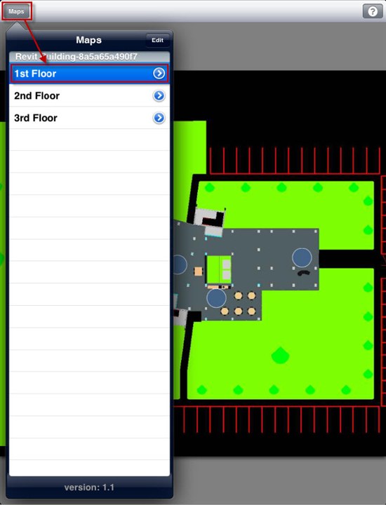

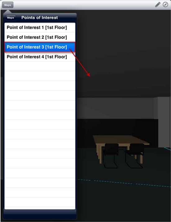

- Once it opens in Navigator you can view the Points of Interest by Clicking the Maps button and clicking one of the maps (ie 1st Floor, 2nd Floor, etc..) (SC10) then selecting one of the Points of Interest (SC11)
SC10
SC11

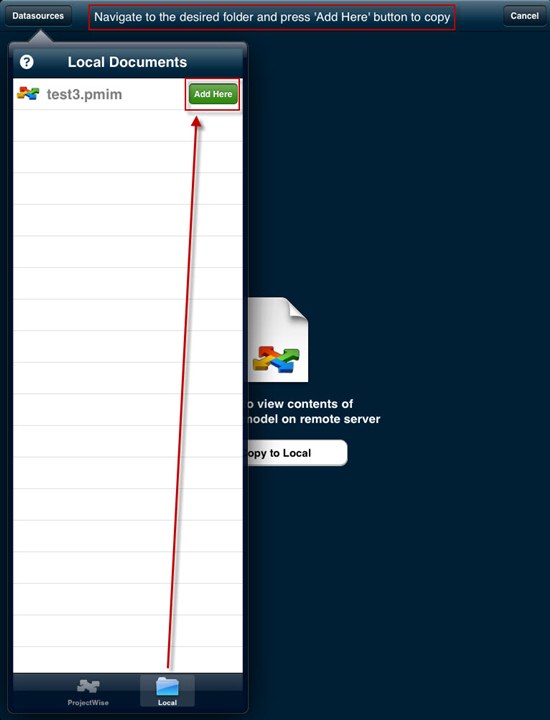

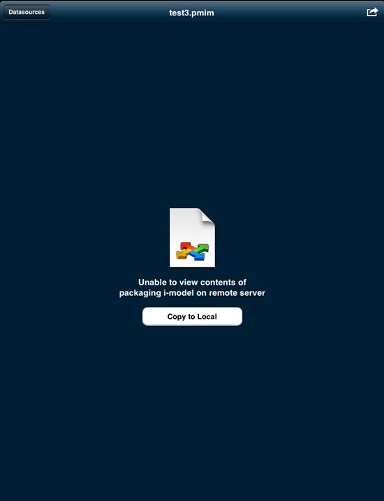

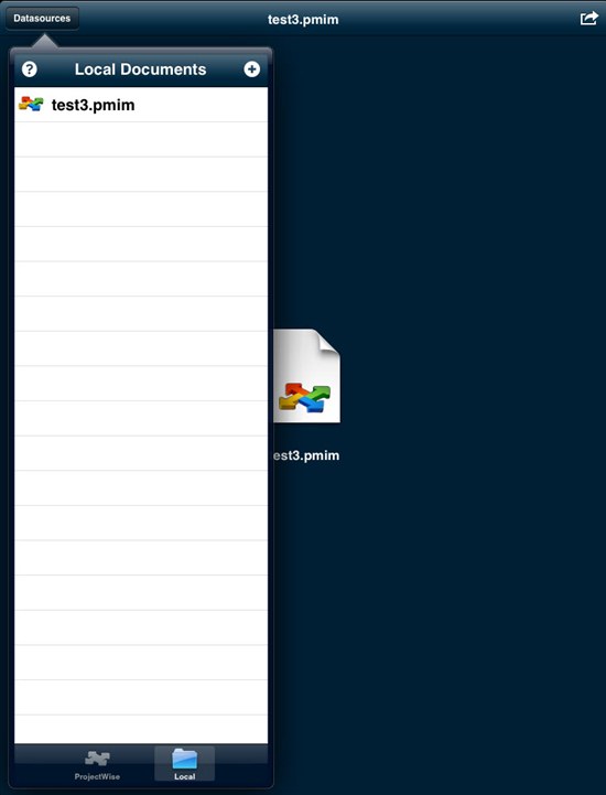

- When working with PMIM files when you click the file you will need to click on the Copy to Local button and place it to the local folder on your iPad, (SC12) then click add here (notice the Local folder is highlighted) (SC13)
SC12
SC13

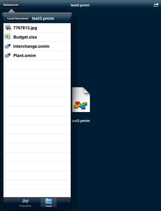

- Once the file is in the local folder (SC14) you can click on the file and it will expand in to the PMIM file and show all content that has been packaged (SC15) Clicking on any of the files will open the application that is associated to the file type. Opening the OMIM file will be the same workflow as above.
