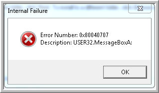

The following occurs when installing PlantFLOW:
Install Failure
Error Number: 0x80040707
Description: USER32.MessageBoxA:

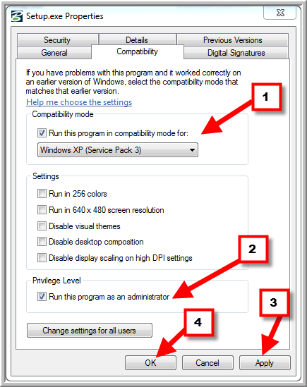

Cause:
This error may occur if there is a missing or invalid path in the registry.
Try the following procedure:
1. Go to the directory that holds the file for launching the installation (for example,C:\BentleyDownloads\ program name\ Setup.exe).
2. Right-click on the installation file and select Properties.
3. A dialog will appear, select the Compatibility Tab, on this tab:
a. Place a check in the check box next to "Run this program in compatibility mode for : Windoes XP (service Pack3)
b. Place a check in the check box next to "Run this program as an administrator"
Press Apply Button and then press OK button to close dialog.
4. Be sure that All Background programs are closed and Temp folder is empty
5. Be sure that Virus Protection has be temporarily turned OFF.
6. Double click on Setup.exe to start installing the program.
