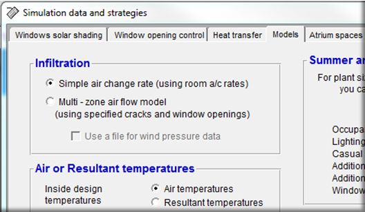

Firstly ensure you have chosen the Multi-zone air flow option, within the Simulator > Design Data > Model menu:
This will then include any Flowpaths set in your rooms.

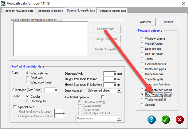

To create the AOV Flowpath:
