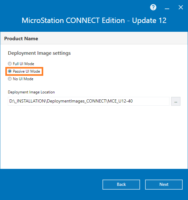

The deployment settings are displayed when you run the setup in/layout mode. Following deployment image settings are displayed in the MicroStation Installation Wizard.

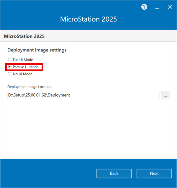

- 'Full UI Mode' - Displays all the installer windows when you install using the deployment image. 'Full UI Mode' is not recommended as full user interaction is needed to run the installation. This is only of value in an atypical situation where individual installations require different options.
- 'Passive UI Mode' - Installs the application in passive mode from the deployment image. In this mode, the installation wizard and the progress dialog are displayed but the installation takes place automatically. The installer takes the options selected while creating the deployment image and you cannot select any options in this mode. The user has full visibility of the installation process.
- 'No UI Mode' - Installs the application in silent mode and is for use with deployment tools as mentioned above, e.g. Microsoft SCCM. No dialogs will be displayed and successful completion of the installation will only be confirmed by reports back to those tools or local event log messages. If an error occurs during installation this may not be obvious to the machine user.
Note that the size of the Deployment Image will vary according to the options chosen. 'Full UI Mode' will be the largest as all available source modules must be downloaded to allow any combination of choices to be made during the installation.

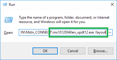

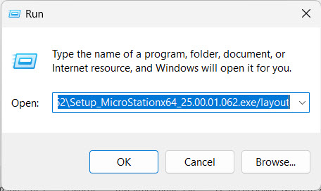

- In the command line, go to the folder that contains the MicroStation setup executable and run the executable with the /layout command.

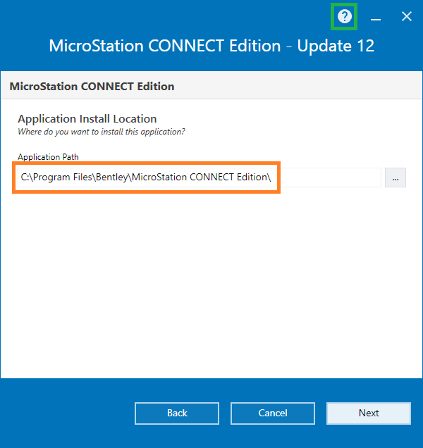

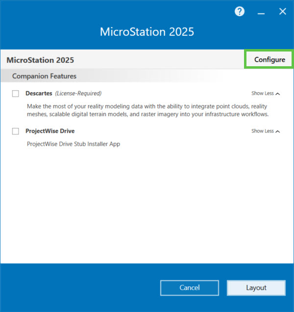

- The MicroStation Installation Wizard opens. (Optional) Click MicroStation CONNECT Edition > Configure to change the installation options.

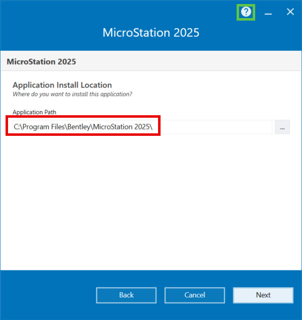

- (Optional) To change the application installation location, click the Browse button next to the Application Path.
We recommend that you accept the default install location unless there is a particular reason not to:
In the 'Browse for Folder' dialog that opens, browse to the drive and folder you want to install the product in, then click OK.
Note that help is available during installation from the icon at the top right.

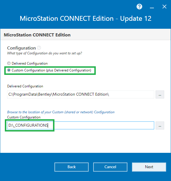

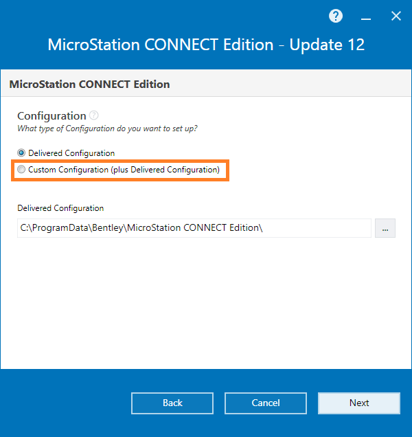

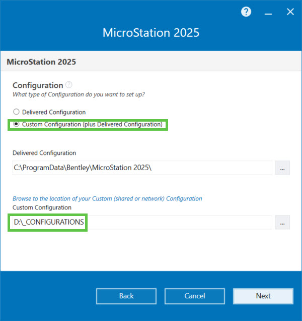

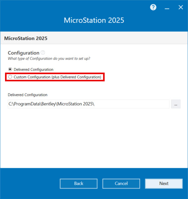

In the following (optional) step we have an option which sets the location of the Custom Configuration during installation. This eliminates the need to run additional procedures to deploy customised configuration files to each installation. We recommend that deployment Images are created using this step.
Select the 'Custom Configuration (plus Delivered Configuration)' option. Browse to the folder where your Custom Configuration will be located, then click next:
The Custom Configuration location does not need to have been populated with content or even to exist for the deployment image to be created successfully. MicroStation will still run without them but only with the delivered configuration and the 'River Bridge' or 'MetroStation' example dataset. Obviously, the Custom Configuration location and content will be required for production installation to be completed.
Note that this is a change from pre-update 4 versions where other options were offered at this point. Organization and Workspace settings are now applied in the copy of WorkSpaceSetup.cfg that will be located in the Custom Configuration.
Click Next to continue.
- Select the installation mode, 'Passive UI Mode' is the default that applies to most situations as mentioned above.
Browse to and select the Deployment Image Location, creating a separate sub-folder for each deployment image:

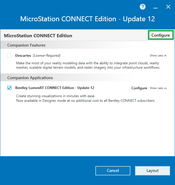

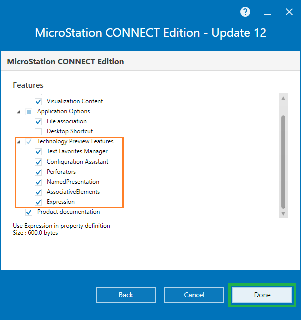

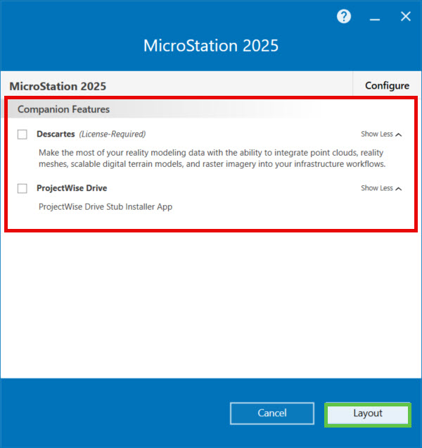

- In the Features stage the optional features that are installed can be modified. The most likely option to consider here will be to omit the Technology Preview Features in production environments where they may not be needed immediately.
Click Done to accept the choices made or back to review.
*If for some reason you are not able to install the Python scripting utility, just uncheck the 'Python' option.

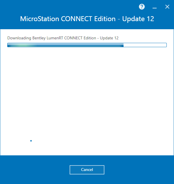

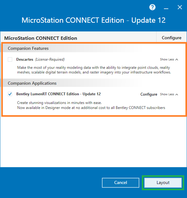

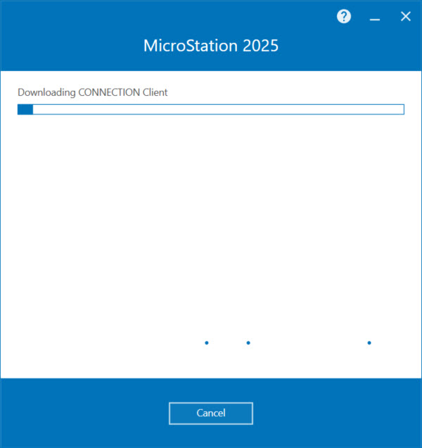

- Check state of Companion Feature and Applications selections then click layout to create the deployment image. The usual installer dialogs will appear, required (or potentially required) components will be downloaded including the Companion Features and applications

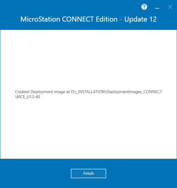

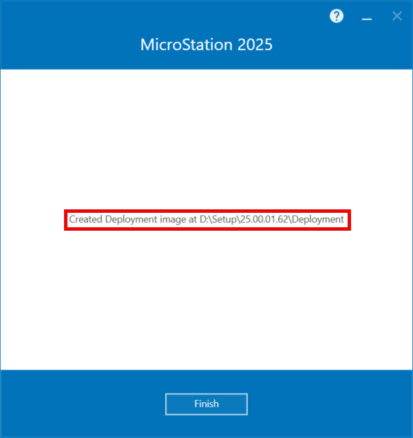

- Click Finish to exit the MicroStation Installation Wizard.
The deployment image is created at the selected location.

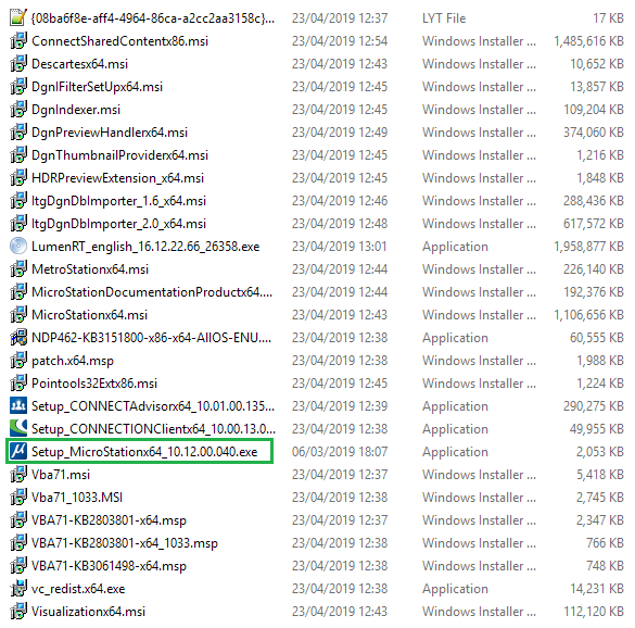

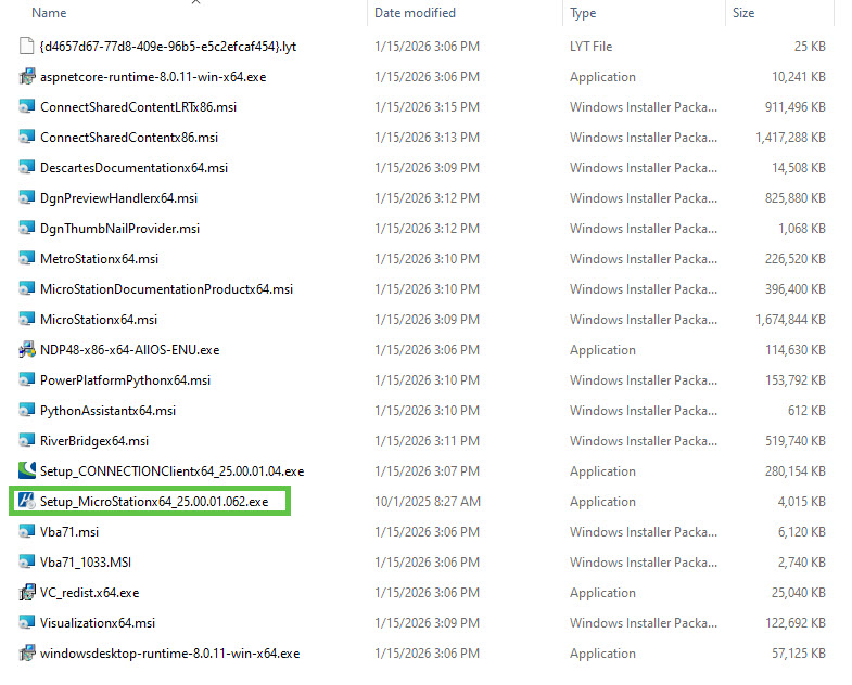

- The resulting files created will be similar to this:
Observe that the MicroStation installation file,installation file and a 1.5Gb CONNECT Shared Content file that contains installation files for companion features and other shared content.
These files are included in the deployment image so that all required files are available on the local network during installation without the need for further online downloads speeding up the installation and avoiding repeated downloads of the same files.
- Run the Setup_MicroStationx64_25.00.01.062.exe to install. This can be done:
- Manually on the machine where the CONNECT Edition application will be installed by browsing to the deployment image location
- Using installation management software as mentioned above.
